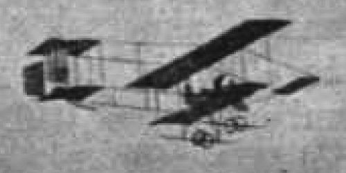

Pilot: Henri Rougier
Pilot: André Frey
This photo appears in a work about Austrian aviation, but it's belived that it shows Frey's machine. Frenchman André Frey should not be confused with German Alfred Frey, who also participated. (2)

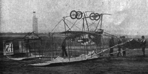

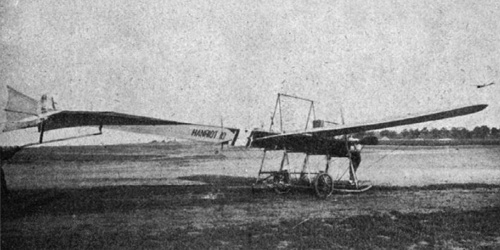

Hanriot
Pilot: Louis Moser and Louis Wagner
Engine: Clerget I-4
#13 was entered for Moser. He only flew 42 seconds during the meeting, but it appears the machine was also flown by Wagner. (4)
