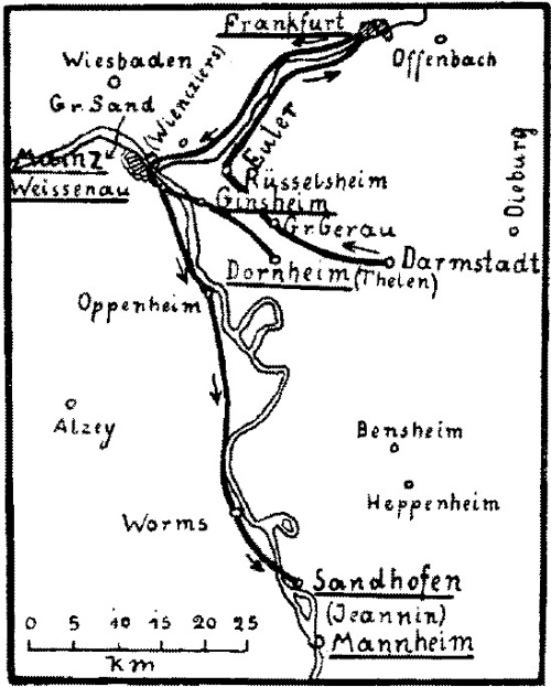

A simple sketch of the course, indicating the flights made by August Euler, Robert Thelen, Eugen Wienciers and Emil Jeannin from August 14th to August 17th. (1)
